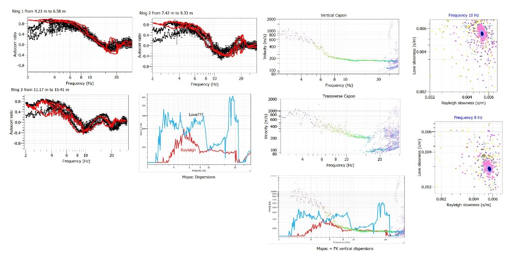

first of all thank you for giving me the opportunity to implement the little I know about the Spac 3C. So far I was stuck on the error message that appears when using spac2disp from the Geopsyland link.
I tried to process with 3.4.2 a file of the tutorial database (lep_ring01_3C.gpy) with the possibility therefore to compare the result with the 1C one published in the Mspac documentation. I used the same inputs reported in the tutorial and the final result is reproduced in lep_ring.page.
There are no Love waves as demonstrated by FK_radial_Capon: the blue curve is therefore unreliable, while the one referred to Rayleigh is confirmed in the sampled area on the frequency-slowness PDF plot in terms of minimum (6Hz) and maximum (20Hz) frequency and also by FK_vertical_Capon output.
Marc,your help would be very useful for a correct reading of the alpha plots and then how to modify the gpdcreport script to get the velocities instead of the slowness.
p.s. In FK.page I have compared the results obtained with RTBF and Capon processed with the default parameters for the different types of process. Beyond the fact that there are no Love dispersions, it seems to me that the quality of vertical Capon is much better than the RTBF one. Is it possible to comment on this?

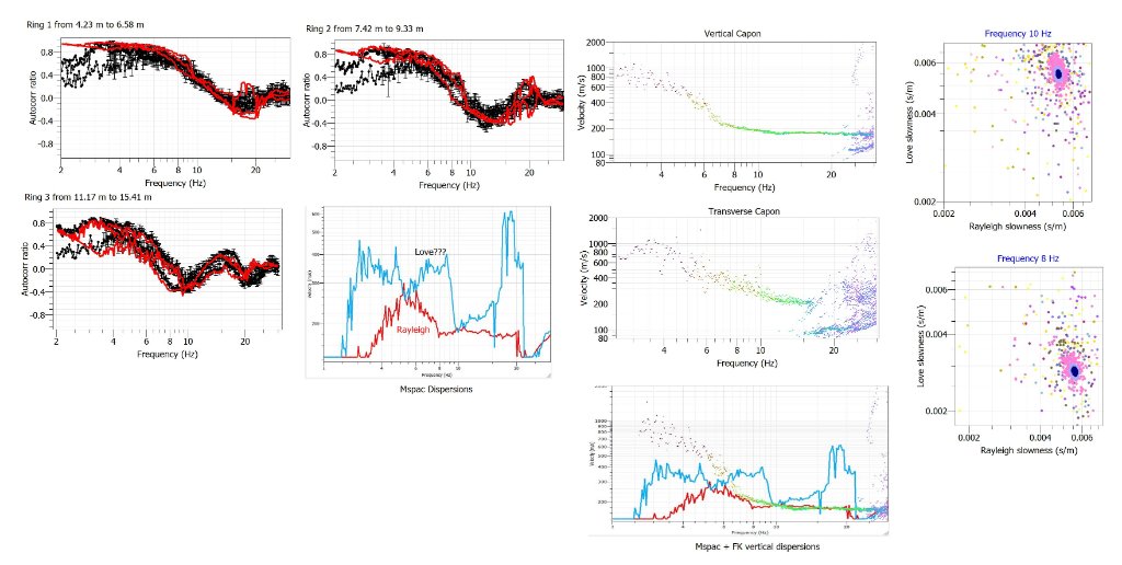

I don't know if I understand your request (I see the page file complete with all the plots) and therefore I am attaching the jpg where all the plots are included.
I don't understand how this can happen. Maybe the jpg files cannot be saved in a sent page file?
I also took the opportunity to replace the radial Capon plot with the transverse Capon plot.
