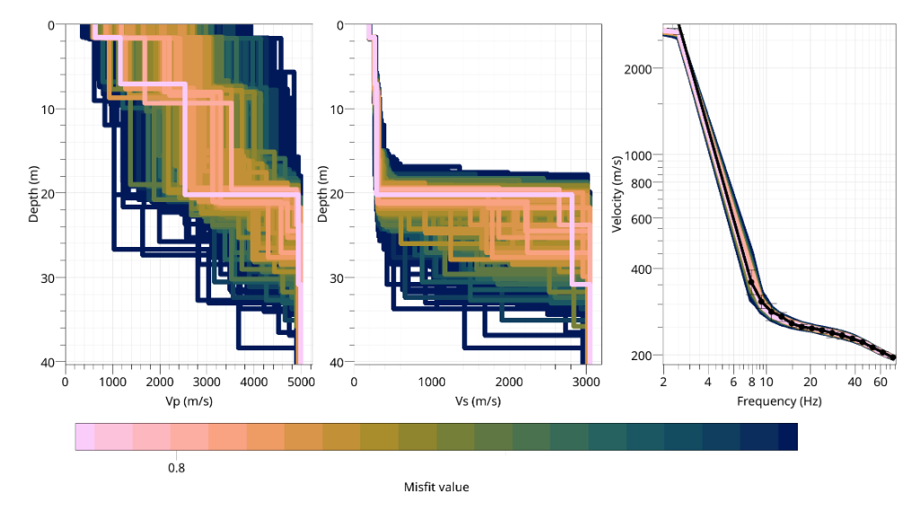

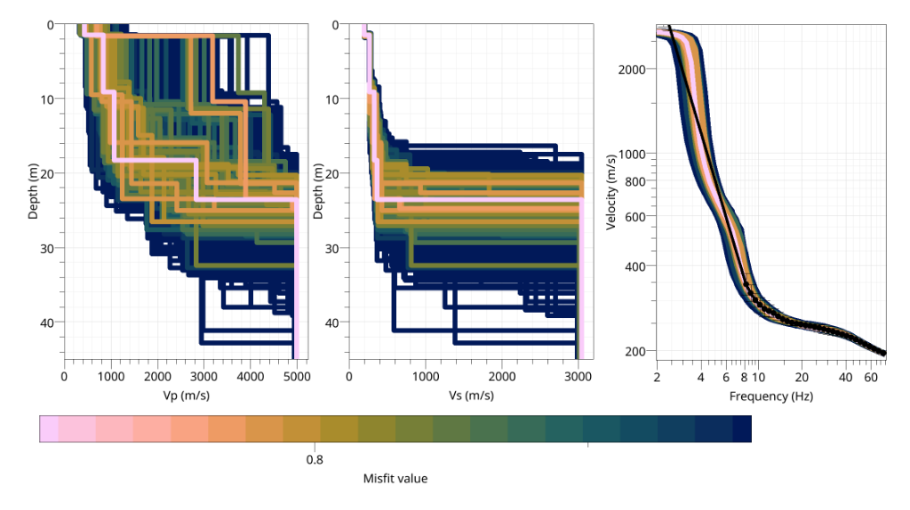

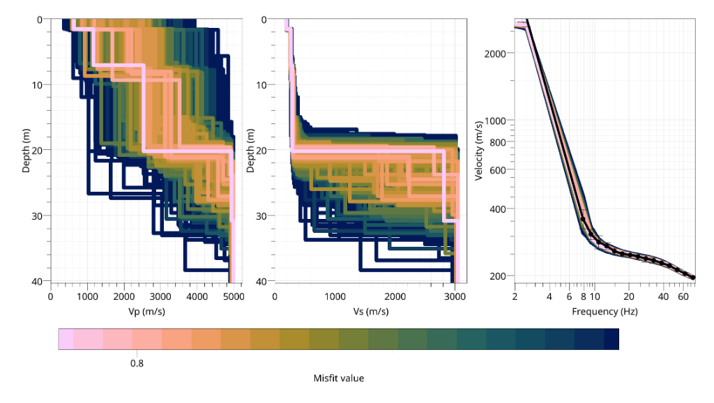

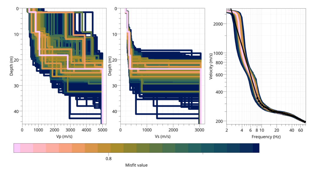

Why are you using so many layers? With 3 layers in the soft part and 2 below 15 m, I got a reasonable fit of the high frequency part. In any case, the low frequency part looks difficult to fit. A contrast around 25 m is inverted. Your dispersion curve has a big gap between 2.53 and 7.88 Hz. In general, it is safer to have a continuous sampling to avoid mode jumping during forward computation. It does not occur here, I test a resampled version of your dispersion curve and the original, I got approximately the same results. See figures.
- (143.82 KiB) Not downloaded yet
- (146.19 KiB) Not downloaded yet
