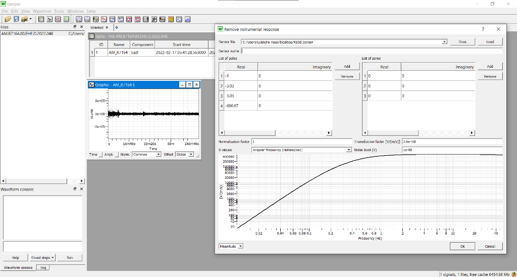

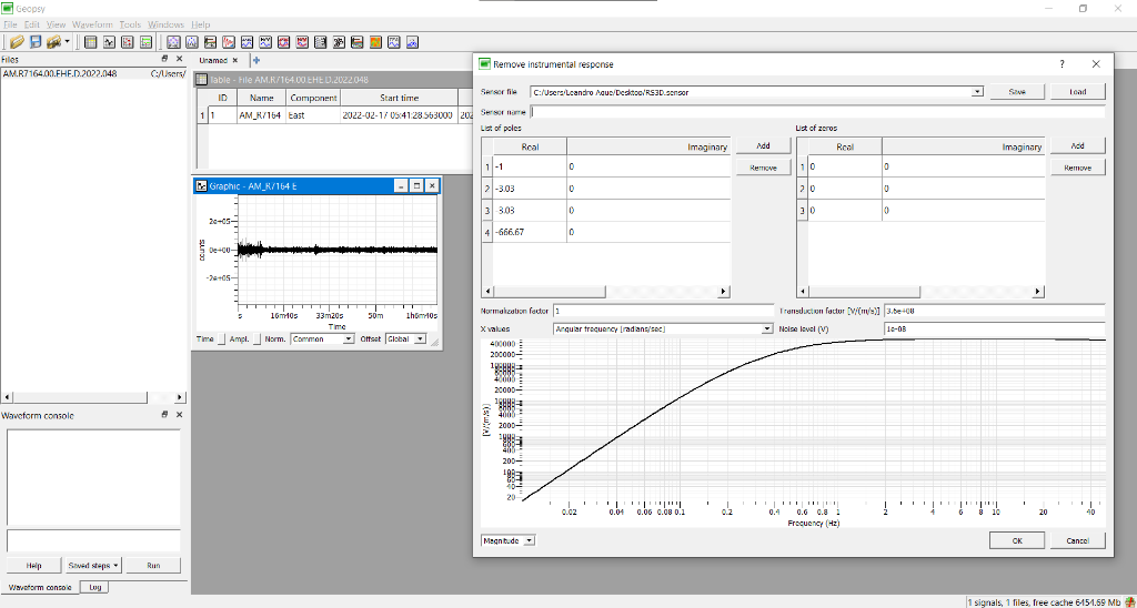

Hi!
I am also trying to perform instrument response removal of data in miniseed format.
I can input poles and zeroes from manufacturer technical specs as shown below. I just have several questions regarding the sample xml file of the Lennartz 5s sensor and other input values:
1. is the transduction factor (V/m/s) the same as "sensitivity (counts/m/s)"?
2. is the normalization factor the same as decimation factor?
3. is the noise level the same as minimum detection threshold?
I have a template instrument response in xml. Thank you so much!
PS. I'm new to instrument response removal. Thank you for your patience
