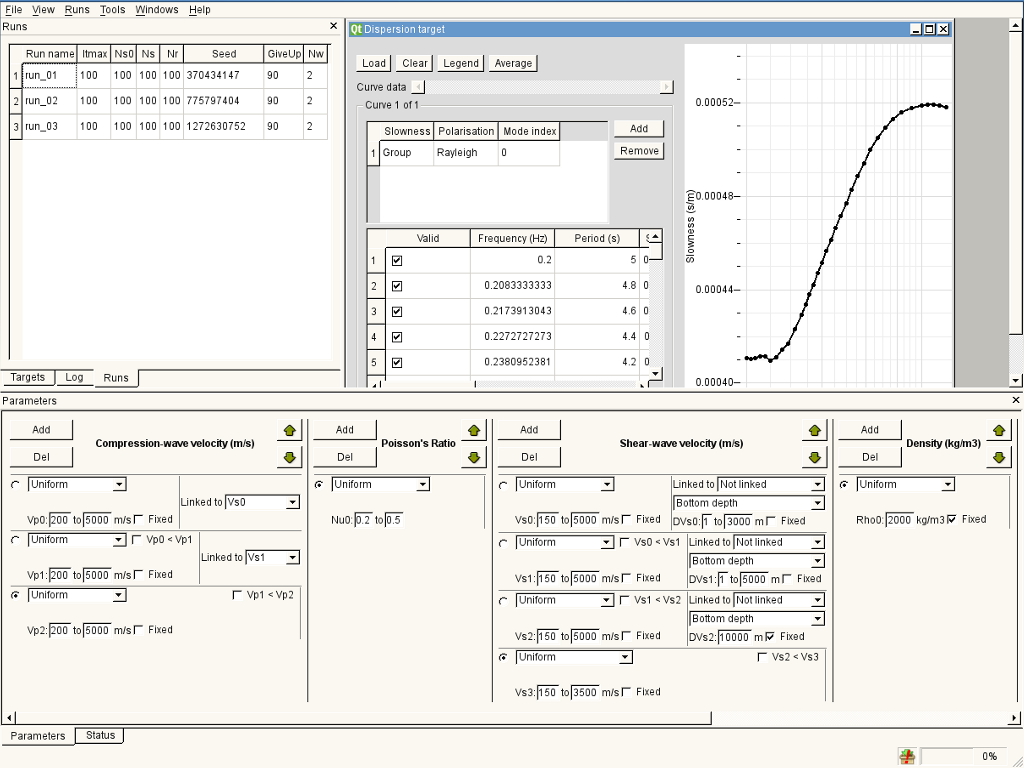

I've been working with 3 layers for compression-wave velocity, 1 for poisson's ratio, 3 or 4 for shear-wave velocity and one for density (fixed). I link Vp to Vs. Vs not linked.

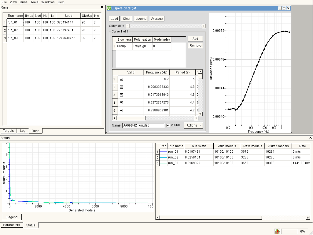

Sometimes I get a different misfit between runs with the same settings, for example a misfit of 0.07 on one run, then 0.01 on another. I guess this is to do with the random seed? The run with the 0.01 misfit gives a good fit to the dispersion curve, though sometimes I cannot get this low misfit every time I perform a run. Is there a way to make it more consistent? tuning the neighbourhood parameters, Itmax, Ns0, Ns, and Nr? At the moment I'm using Itmax=200, Ns0=100, Ns=100, Nr=50.

The seed value has little meaning... especially for a parallelized NA core. We are keeping the seed adjustement for debug purposes only. In this case, a single threaded inversion must be used (dinver started from command line with "dinver -j 1", see "dinver -h all" for details). According to the CPU load on your cores, the set of generated models will never be exactly the same, even with the same seed.
Having distinct misfits for distinct runs with the same parameters is to be expected when the inversion is not perfectly exploring the parameter space. When the number of layers is increasing the complexity of the parameter space increases as well, and the minimum is more difficult to find. About your tuning parameters, I would not suggest to have Ns>Nr if you want to achieve the best exploration. One extreme case is Nr=1, a very selective one. The inversion gets easily trapped in local minima and great variability in obtained misfits is expected.

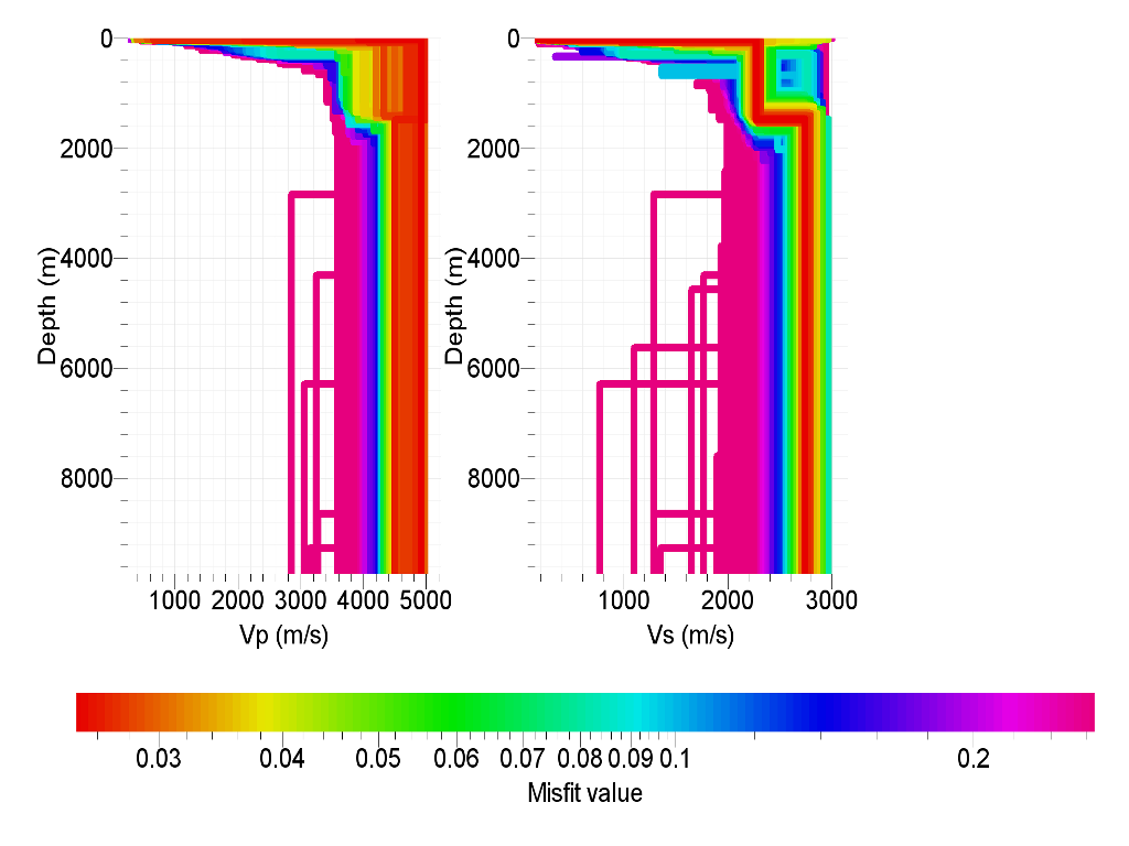

With the different misfits between runs I do get different looking profiles. For example, Vs is calculated to a depth of 2000m or 4000m for one run, while another run it's calculated down to 10000m.

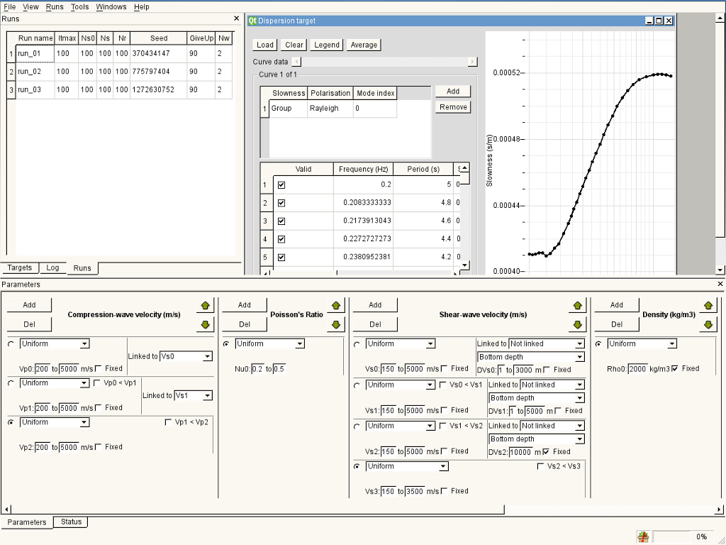

I want to constrain the depth to 10000m to make it more consistent. For the bottom layer I ticked the 'fixed' box for DVs0 to 10000m, then HVs1 and HVs2 as thickness for 1 to 10000m range. However I still get profiles of varying depths between runs. How could I force the solutions for Vs to have a specified depth?
Counting of layer is in the other way. If you have 4 layers, DVs0 is the depth of the most superficial and DVs2 is the depth of the deepest interface. I would not use thicknesses but depths for all layers. I kept thickness during development, to test and compare things. As explained in Wathelet (2008, GRL) depths are better than thicknesses for stochastic methods. If you want the deepest interface at 10 km, yes, you can tick the fixed check box, or if you not 100% that it is 10 km, leave a small range of variation.

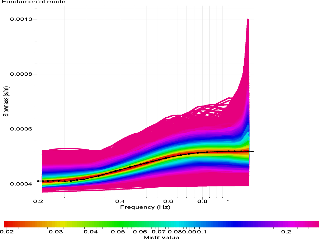

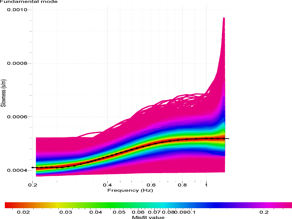

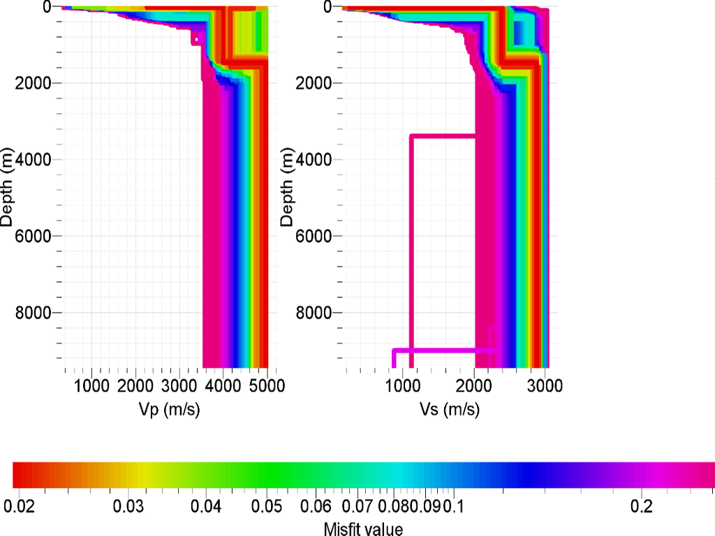

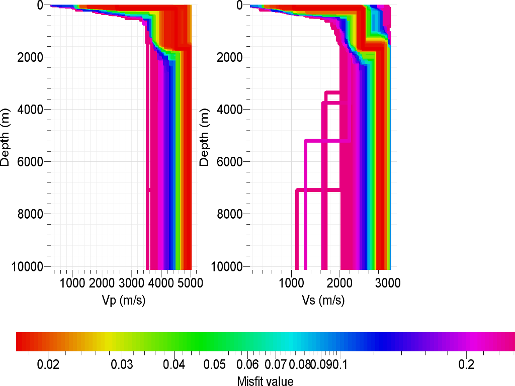

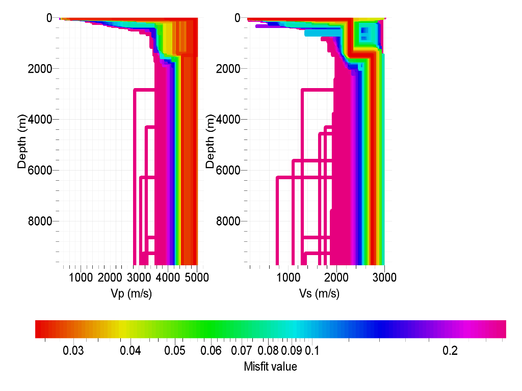

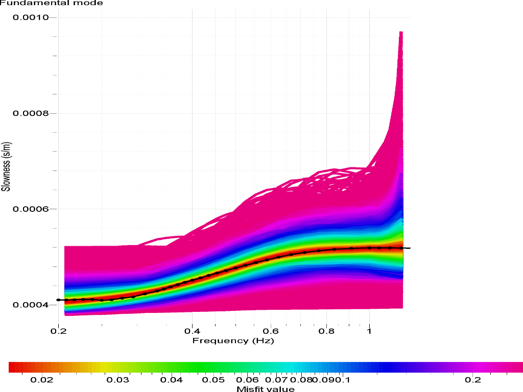

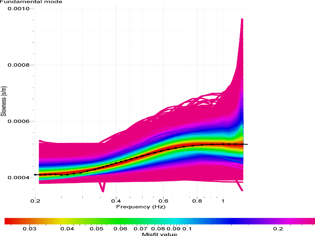

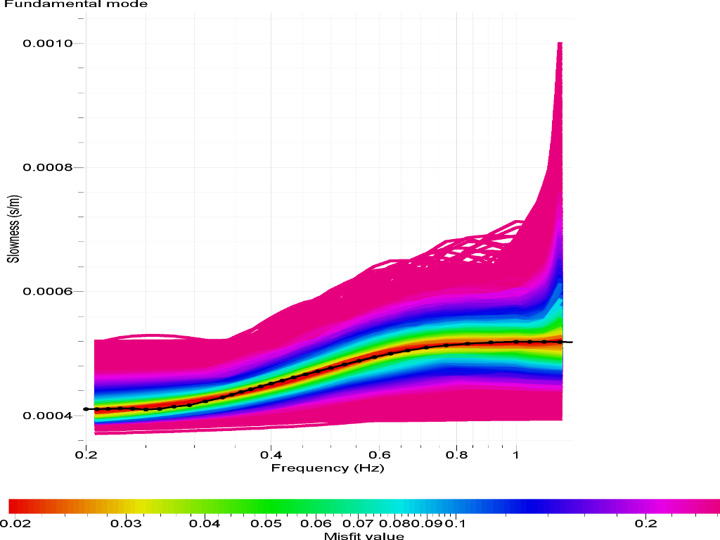

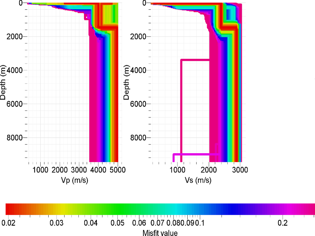

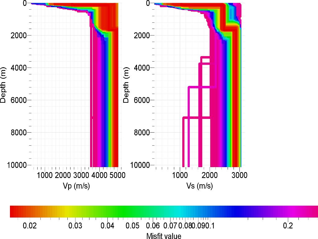

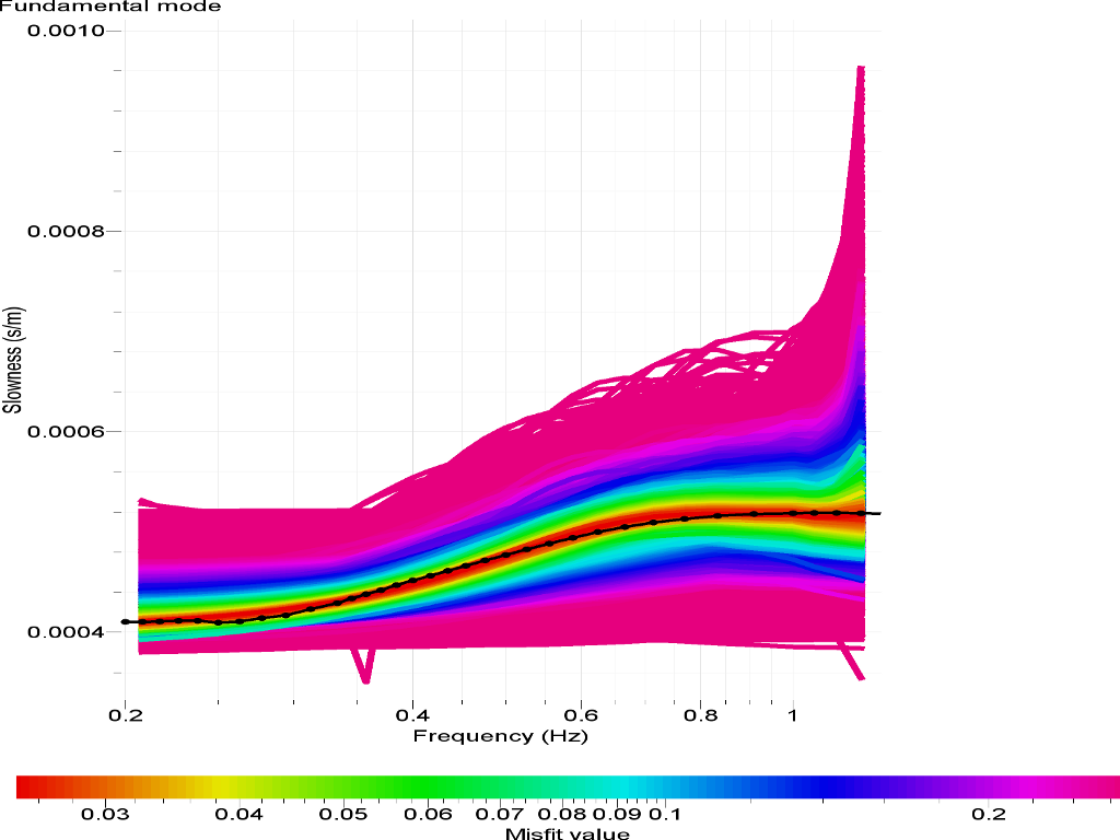

I fixed the deepest layer (DVs2) to 10km, though when I plot the ground profiles (View -> ground profiles) the depth on the y-axis sometimes doesn't go all the way down to 10km. Is this because the program only plots velocity that varies? If the velocity doesn't change after a certain depth (i.e. profile goes straight) it's not included in the plot?
profile run1
(109.49 KiB) Not downloaded yet
profile run2
(67.04 KiB) Not downloaded yet
profile run3
(79.93 KiB) Not downloaded yet
dispersion run1
(119.08 KiB) Not downloaded yet
dispersion run2
(123.29 KiB) Not downloaded yet

dispersion run3
(124.14 KiB) Not downloaded yet
display status
(152.48 KiB) Not downloaded yet
display parameters
(189.67 KiB) Not downloaded yet
Re: Defining Parameters in Dinver (Parameterization)
Looking at your figures, there is something wrong but can't find what it is. Can you save the dinver environment (File/Save as) and send me the .dinver file. *_report directory is no required.
You'd better tick the Vs*>Vs* or Vp*>Vp* conditions, at least for the last layer (the bottom half space). For the majority of models, if the Vs3 (in your case) is less than for upper layers, leaky modes are common and the forward computation will certainly fail, which does not hurt too much the final result except that it slows down the process. If you remove that condition for all other layers, you can drastically increase the non-uniqueness of the problem. Usually, I remove that condition only under special circumstances when the geology supports it or if there is no other way to fit a dispersion curve.
Having a look at your dinver file, I finally got your question, sorry for the delay:
The answer is simply yes. The y axis is adjusted to the deepest velocity change plus a small percentage (cannot remember how much exactly). If you want to plot things down to 10 km you can adjust the y-axis range using the properties (context menu or double click on the graph).
When you create an inversion run, the current target and parameterization is copied into the new run. In other words, if you change the parameterization afterwards if does not affect the already created runs. To review the parameters and the targets of the run created so far, you can switch to "show" mode in menu "Run". The parameter window becomes read-only. Hence, the 3 runs you created have all 3 layers from 1 to 10 km, none of them has a fixed depth at 10 km as stated in the current parameterization, valid for next created run. If these explanations are somewhat unclear, do not hesitate.
