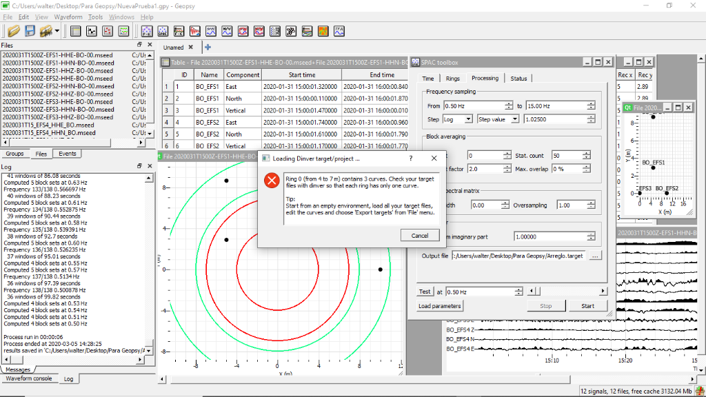

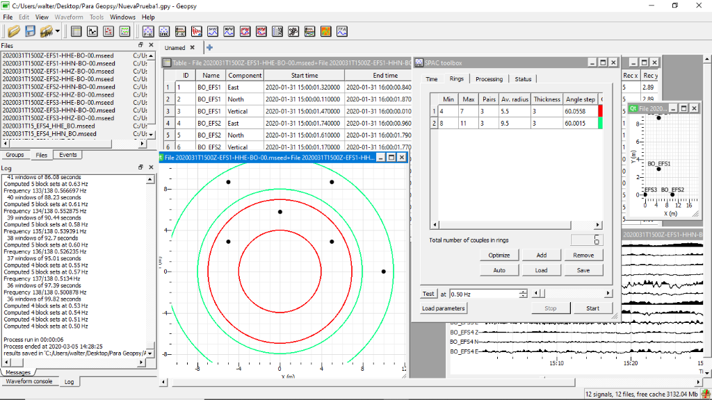

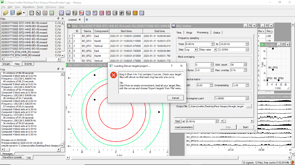

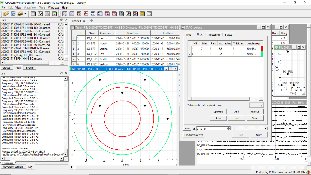

At first, thanks for your software.
I'm sorry if I change the topic. I'm using SPAC processing, I drew the rings with my array.
The configuration is the following:
Ring1:
Min=4, Max=7, Pairs=3, Av.Radious=5.5., Thickness=3, AngleStep=60.05
Ring2:
Min=8, Max=11, Pairs=3, Av.Radious=9.5., Thickness=3, AngleStep=60.00
But when I want to open my target file a warning message appears saying:
Best Regards
Walo
Ring1:
Ring2:
Please, could you tell me what is the reason for this warning?.Ring 0 (from 4 to 7 m) contains 3 curves. Check your target files with dinver so that each ring has only one curve.
Best Regards
Walo
- (300.2 KiB) Not downloaded yet
- (319.36 KiB) Not downloaded yet
Re: SPAC use
This is probably too late. In which application do you get this message? In spac2disp? In dinver? Normally fresh .target file generated by geopsy contain only one autocorr curve per ring.
