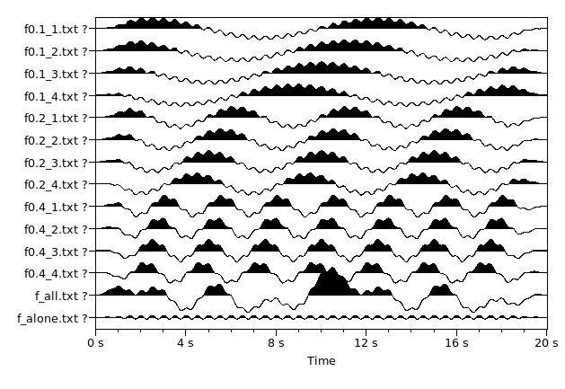

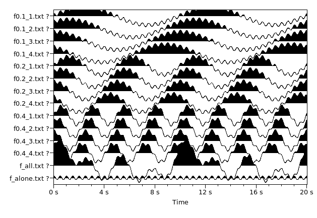

Effect of high-pass filter before cutting time windows

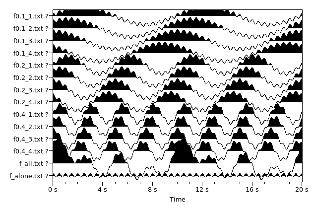

Here are some pictures for a synthetic signal made of simple harmonic functions (generated with http://www.geopsy.org/documentation/gpsignal).
  • f_alone is a cosine at 2 Hz
  • f0.1 is two cosines at 0.1 and 2 Hz
  • f0.2 is two cosines at 0.2 and 2 Hz
  • f0.4 is two cosines at 0.4 and 2 Hz
  • f_all is 4 cosines at 0.1, 0.2, 0.4 and 2Hz
Extensions _1 to _4 have different phases from 0 to PI/2. The amplitude ratio between cosines below 1 Hz and the one at 2 Hz is 5.

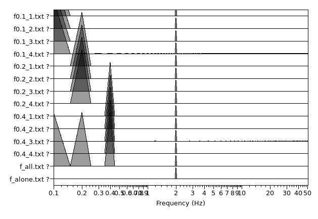

  1. Signals in time domain, without tapering:

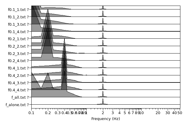

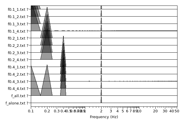

  2. Signals in frequency domain, without tapering:

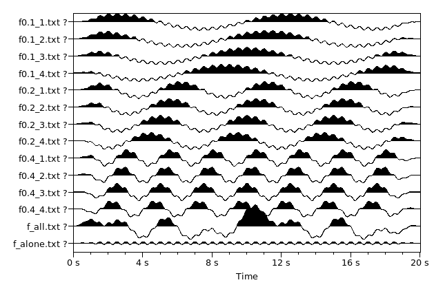

  3. Signals in time domain, after a taper:

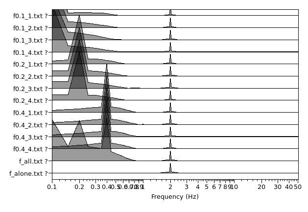

  4. Signals in frequency domain, after a taper:
Conclusion: if there is sufficient energy just below the frequency corresponding to a period of 1/10 of the time window (0.5 Hz in this case), the spectrum may be modified up to 1 Hz. To avoid using very long time windows, better to high pass filter your signals before computing H/V.
