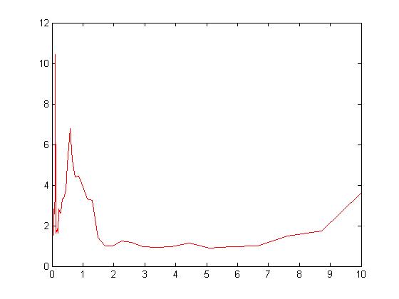

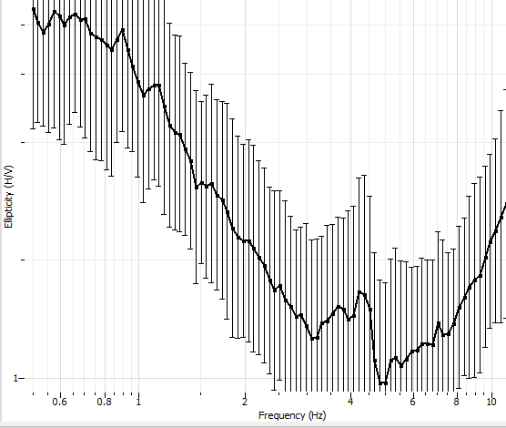

I have used two different methods to calculate ellipticity of Rayleigh wave:
1- First, The method and the MATLAB code released by Dr. M.Hobiger to calculate the ellipticity using Raydec method
2- Using hvtfa tool included in Geopsy software
The results collected for a real site in Iran are like the following.
Regardless of the misfit, curves smoothing and etc because these results are the primary results, I have some questions here.
1- What is the reason for the high variations in the vertical axis (amount of h/v) of very low frequencies in Raydec method, which are happened from obtained results from the diverse ambient noise recording and diverse sites?
2- Since I have no contacts to Dr. M.Hobiger and if you have ever used the code he has developed, could you please explain the reason for using "ginput" function in the code and what exactly this part of the code does?
