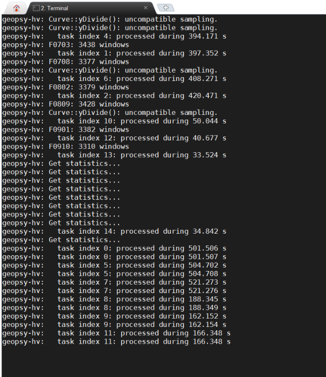

I wondered if there is any way to create the database for geopsy-hv using the command line instead of using the GUI?
When I run only 1 station data using geopsy-hv, it works well but when I give it a larger database consisting of a few more stations it stops. (screenshot attached).
