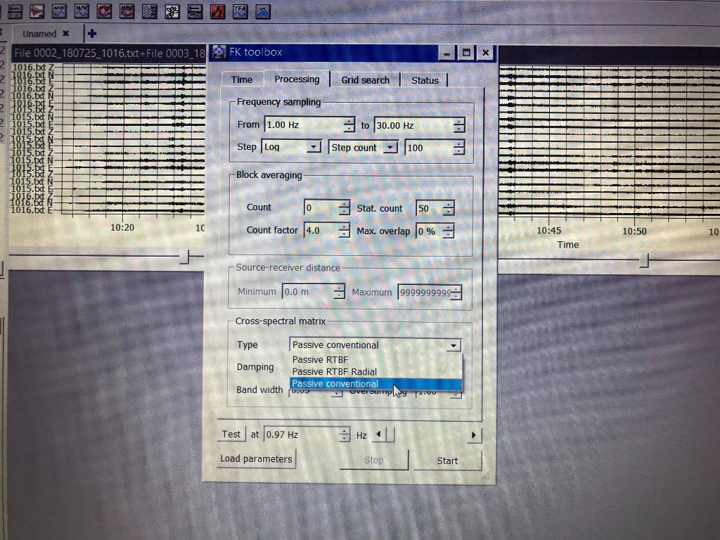

Go into the FK toolbox, with 3.4.2, the list of available process types has been updated. If you provide horizontal or three-component signals, "CaponTransverse" is available. Not with only vertical components.How I have to do to run the CaponTransverse graphical interface?

Sorry, but as you can see, in the release 3.4.2 downloaded, CaponTransverse is not in the process list.How I have to do to run the CaponTransverse graphical interface?
