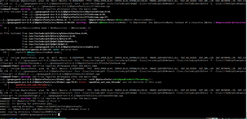

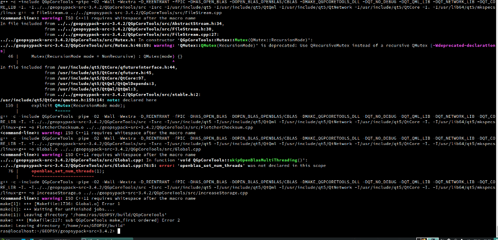

I am trying to compile Geopsy 3.4.2 on OpenSUSE. I am getting the known error related to OpenBLAS during compilation, please see below.
geopsypack-src-3.4.2/QGpCoreTools/src/Global.cpp:76:5: error: ‘openblas_set_num_threads’ was not declared in this scope

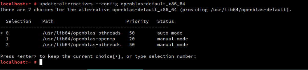

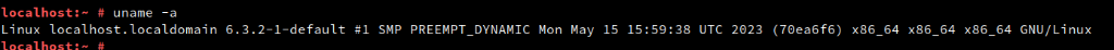

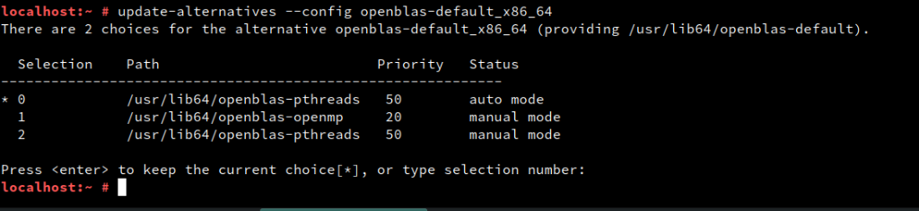

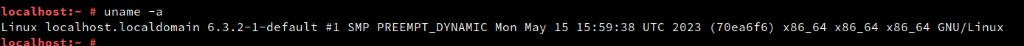

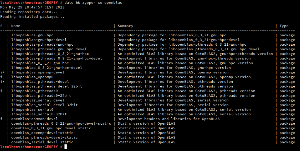

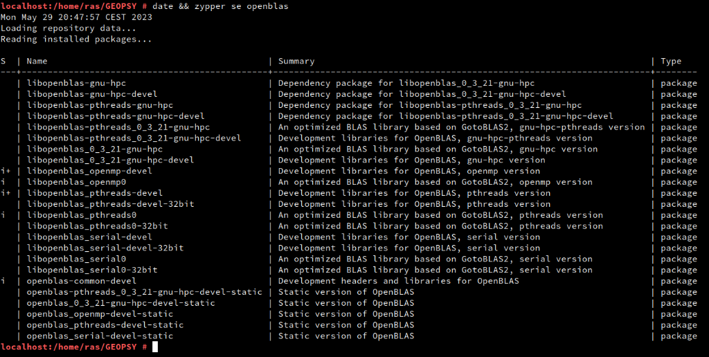

openblas dev package has been installed but the issue is still there, please see attached screenshots and txt files for more details.

Re: OpenBLAS-DEV issue on OpenSUSE
I guess that it is linked to a bad define related to the link to OpenBlas.
Can you edit the file "QGpCoreTools/configure-3.4"?
At line 645, you should find:
Replace it by
Two square brackets must be added in the sed command.
Restart the configure script. You can run "configure.cache" to keep the same arguments.
Does it get better? I'm waiting for your confirmation before introducing this modification for the next releases.
INCLUDE_DEFINE=$(echo $OPEN_BLAS_INCLUDE | awk '{print toupper($0)}' | sed "s/-\\//_/g")Code: Select all
INCLUDE_DEFINE=$(echo $OPEN_BLAS_INCLUDE | awk '{print toupper($0)}' | sed "s/[-\\/]/_/g")Restart the configure script. You can run "configure.cache" to keep the same arguments.
it works, the compilation has finished successfully. Thank you!
