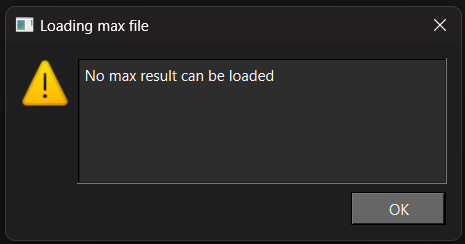

Hi Marc!
Thank you for the new geopsypackage 3.5.2 as well as the constant effort to provide us geopsy users much needed updates!
Is max2curve still working on this current version? I've also been trying to import .max file in GeopsyLand but to no avail. Is there a way that I can do the same function in gphistogram in picking flanks/peaks/troughs? My purpose is to create 1d velocity profiles from HVSR recordings.
Thanks again!
(13.5 KiB) Not downloaded yet
Re: max2curve in 3.5.2
max2curve is supposed to work for HVTFA results only. All the other features are no longer maintained. They were moved to gphistogram and gpviewmax. Analysis of HVTFA should be moved to gphistogram as well, but it is still pending. If you experience malfunctioning in 3.5.2, can you post an example of a .max file? If there is something wrong, 3.5.3 will be out soon and it can be fixed there.

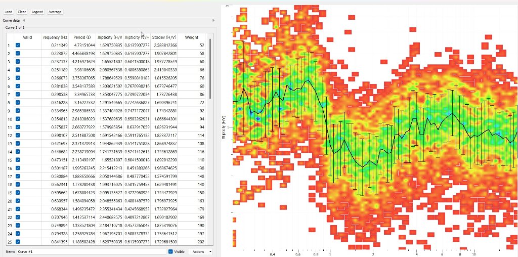

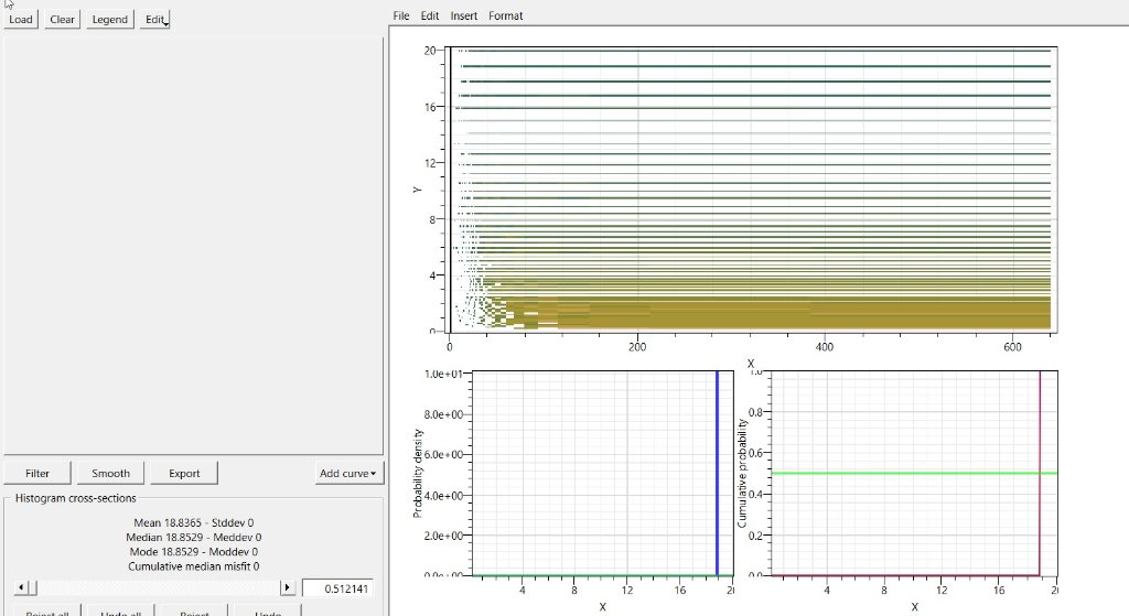

Therefore max2curve of versions 2 can work without the sixth column and correctly reproduce the histograms even of files with 5 columns (4165HVTFA).
But does it also mean that the .max files produced by HVTFA can be viewed by gphistogram and gpviewmax?
(151.44 KiB) Not downloaded yet
With gphistogram, any two column stream can be read. You just have to select the right columns with the command line options. gpviewmax is more "rigid", I guess it is not possible.
